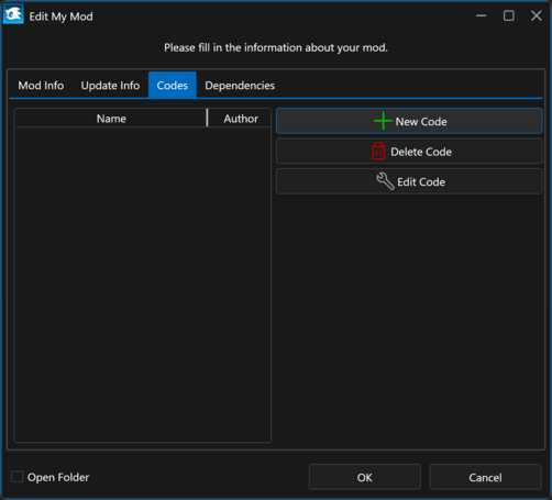

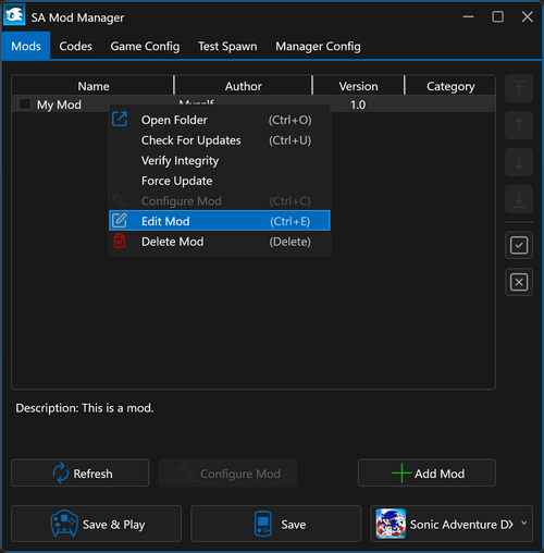

First edit your mod by right clicking it and clicking on Edit mod, or by selecting it and pressing Ctrl + E.
Then go in the "Codes" tab and click on "New code".

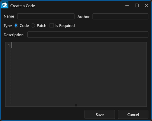

You are now in the cheat code editor :
Fields are:
- Name*: short name for the cheat code.
- Author: author(s) of the cheat code.
- Type*: "Code" will make your cheat code run every frame, "Patch" will make it run once at start up.
- Is Required: if checked, the cheat code will be forced on and won't appear in the Mod Manager "Codes" tab.
- Description: description of the cheat code.
To write the code, see Writing a cheat code.
When finished, save the cheat code, enable the mod and click "Save" to compile the cheat codes.
