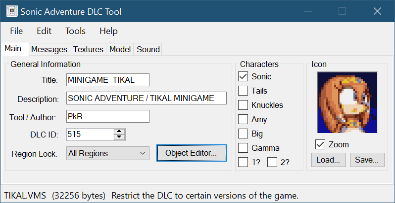

Main Tab
Here you can change header information, set DLC regional and character locks and access the item table.
Icon
The icon must be a 32x32 bitmap. It's recommended to prepare a 16-color image for the icon. If the icon has more colors, it will be converted to a 16-color image with quality loss.
About the DLC ID field
For the game to recognize the DLC, its filename on the memory card should be SONICADV_XXX, where XXX is a 3-digit number unique to each DLC. IDs 0-199 are reserved for Japan-only DLCs. If you use a number lower than 200 for the ID, the game will only display messages in Japanese.
Apart from the filename, DLC ID can also be stored in the VMS file itself. If the DLC sets up a challenge with a timer, the DLC ID is saved in the upload data produced by the game. The DLC ID field in this tool sets both the filename and the field in the file.

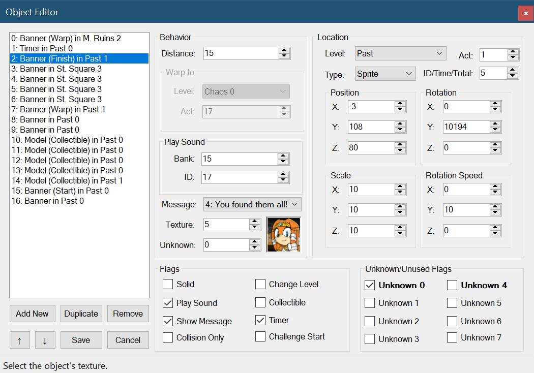

Object Editor
This editor lets you change the item table.
Object Flags
Solid - Enable collision.
Play Sound - Play a sound when the object is triggered. The sounds are restricted to currently loaded soundbanks which depend on where you are in the game. You can add a custom soundbank with sound effects or sequenced music via an MLT file. You can also play ADX music from the disc.
Show Message - Show a message when the object is triggered.
Collision Only - Disable all interactive elements and use the object as invisible collision.
Change Level - Teleport the character to a different level when the object is triggered.
Collectible - Make the object collectible. You can have up to 255 collectible objects.
Timer - Use the object to count the time and keep track of how many items have been collected. The timer works everywhere and does not reset if you go to another area, including different Acts of a stage, a different Action Stage or a different Adventure Field.
Challenge Start - Use the object to start the timer.
Notes and Tips
  • You can use SALVL to get coordinates and rotation for your objects. Use any SET file or Sonic's start position as a placeholder. Alternatively, you could use the Debug Mode mod to retrieve the player's coordinates ingame and use them for your objects.
  • An object cannot have both Play Sound and Change Level flags at the same time.
  • The Texture field sets texture ID on the sprite or the first material of the model.
  • For Timer objects, the ID/Time/Total field stores the number of objects to collect.
  • For Challenge Start objects, the same field stores the time limit. The format is the number of seconds divided by 10, e.g. 60 is 10 minutes.
  • For Change Level objects, the Warp to: Level field stores the level ID and the Warp to: Act field stores the act ID.
  • For Play Sound objects, the Bank field stores the soundbank ID and the ID field stores the sound ID in the soundbank. Bank 8 is the DLC soundbank, 15 is ADX music.
  • You can stop the stage's regular ADX music by playing bank 15 sound 110.

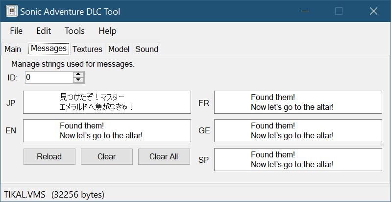

Messages Tab
Text strings must be 64 characters long or less. Japanese strings must be 32 characters or less. Use TAB (actual tabulation) for text centering.

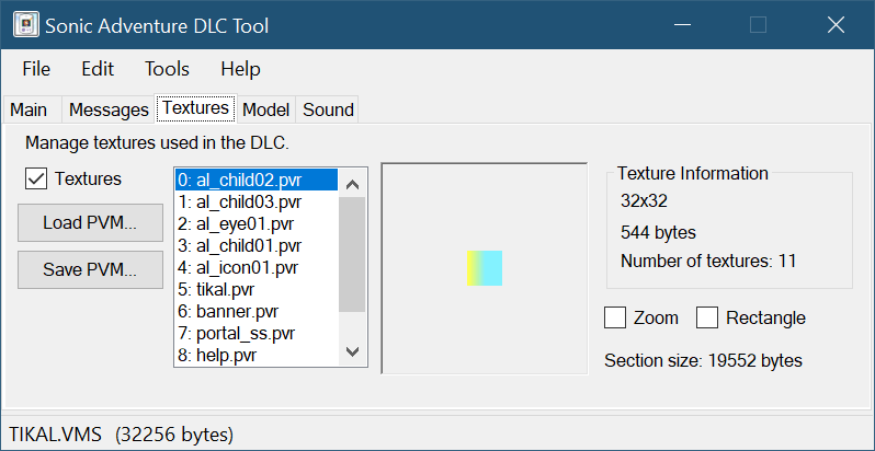

Textures Tab
The tool can import PVM files created with Texture Editor or ArchiveTool.
  • To save space, use as few textures as possible and compress them using the VQ4 PVR format. You can save textures in this format using the PVR plugin for Photoshop.
  • You can also squish rectangular textures into squares for use with rectangular banners. Use the Rectangle checkbox to preview them in stretched mode.

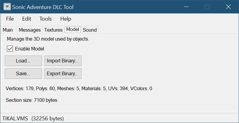

Model Tab
The DLC can store a single Ninja Basic model. You can add a model in SAModel's .sa1mdl format using the Load... button, or import a model from another DLC's extracted data (PRS or BIN file) using the Import Binary... button. The tool manages model data automatically. If you use a model in .sa1mdl format, you don't need to create a PRS file.
You can also export the model in .sa1mdl format using the Save... button or export binary model data as BIN or PRS using the Export Binary button.
  • To save space, make your model as low poly as possible. Reduce the number of materials, vertices, meshsets etc. You can see the amount of data occupied by the model at the bottom of the Model tab.

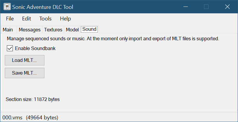

Sound Tab
The tool can import and export Dreamcast Multi-Unit (MLT) files.
  • The soundbank in the MLT file is loaded as Bank 8 in the game.
  • At the moment SA Tools cannot edit MLT files, although you can extract some information from them using the MLTExtract command line tool on the SA Tools Research repo. A new suite of tools for working with MLT files is also in development.
