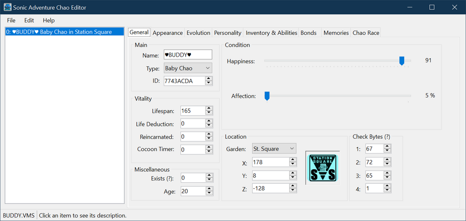

Using the Editor
The panel on the left lists all Chao data entries in the file currently opened. The tab control on the right allows you to edit Chao data for the selected entry. When you click around in the UI to edit Chao data values, a description of the value is shown in the status bar for all data that is currently known.
  • The General tab contains general information on the Chao such as its name, type, age and happiness.
  • The Appearance tab contains the information on how the Chao should look, such as color, animal parts, personality traits used for face textures etc.
  • The Evolution tab contains the Chao's stats and lets you customize its development to evolve towards a certain Chao type, such as Swim, Fly etc.
  • The Personality tab lets you edit the Chao's emotions that influence its behavior in the gardens and in Chao Race.
  • The Inventory and Abilities tab contains information on fruits the Chao has and its skills learned from animals.
  • The Bonds tab lets you change how much the Chao likes a particular character.
  • The Memories tab shows data on the Chao's interaction with other Chao. It doesn't seem to be functional ingame.
  • The Chao Race tab lets you edit a Chao's personal race records and jewels won in the races, as well as garden race records.
You can save the edited data as a regular Garden Save, Chao Download Data or as a Chao Adventure file.
