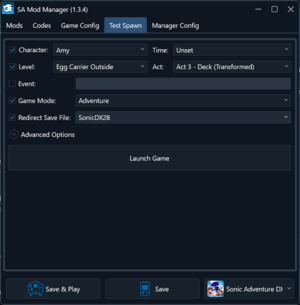

Using Test Spawn
To test your mod, you can use the Mod Manager's Test Spawn tab (make sure developer settings are enabled in the Manager Config tab) to bypass all menus and put a specific character in any stage or cutscene. You can also specify a save file override or set up a specific position in the stage.

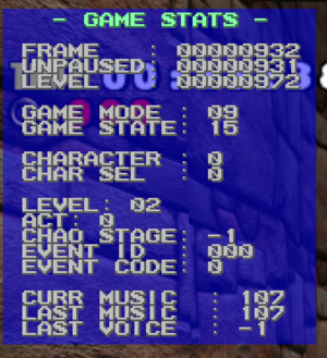

1 - Game Stats
Press 1 to access game frame counters, game mode, game state values etc.

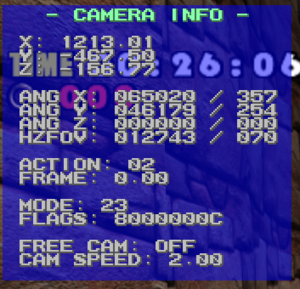

3 - Camera Info
Press 3 to view position, rotation and flags of the camera object. Press H to switch between decimal and hexadecimal representation of angles.

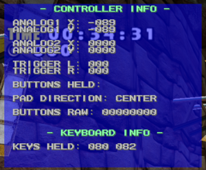

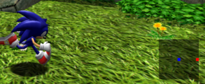

4 - Controller Info
Press 4 to view information about the controller and the keyboard.
In the bottom right corner you can see the visualization of analog stick movement. The red square represents the left stick (movement), and the blue square represents the right stick (camera).

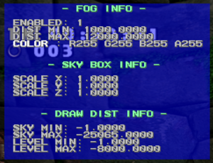

5 - Fog Info
Press 5 to view information about stage fog, skybox and draw distance.

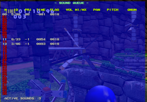

6 - Sound Queue
Press 6 to view a list of currently playing sounds. You can press the H key to toggle between decimal and hexadecimal sound IDs, as well as their IDs in the soundbank.

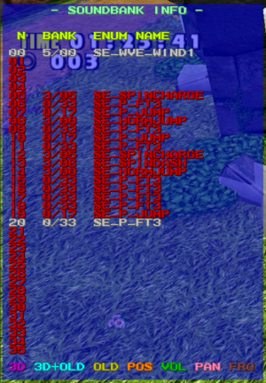

7 - Soundbank Info
Press 7 to view information about recently played sounds and their corresponding soundbanks. You can see their soundbank IDs, IDs in the soundbanks and the names of the sounds.

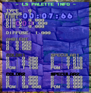

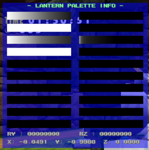

8 - Lantern Palette / LS Palette Info
Press 8 to view lighting information.
When the Lantern Engine mod is enabled, this screen shows currently loaded stage and character palettes, as well as light direction information. You enable a debug palette by pressing L, and toggle between various debug palettes by pressing H while this screen is active.
When the Lantern Engine mod is disabled, this screen shows LS Palette (vanilla character lighting) information. You can cycle through currently active character lights by pressing H.

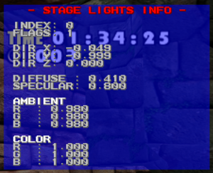

9 - Stage Lights Info
Press 9 to view information about current stage lights. This information is only relevant when the Lantern Engine mod is disabled. Use the H key to cycle through currently active stage lights.

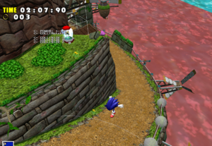

Vanilla Debug Mode
If you press the Z button on the controller (or the B key on the keyboard) while also holding the A button (or its keyboard counterpart - X key by default), vanilla debug mode will be enabled. To disable the vanilla debug mode, press the same button/key combination again.
Collision objects, paths and some debug strings are visible in this mode. When this mode is enabled, you can move the character freely through any obstacles. Use the analog stick to position the character on the X and Z plane. Hold the X button to move the character up and down.
