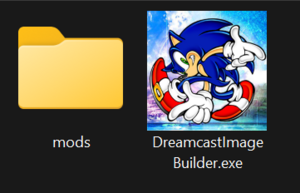

In addition to built-in mods, Dreamcast Image Builder can load mods from the mods folder located in the same folder as DreamcastImageBuilder.exe (if the mods folder doesn't exist, create it).
The mods folder

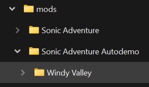

You could also use subfolders for mods meant for different games. In the screenshot below, mods for Sonic Adventure and Sonic Adventure Autodemo are put in different subfolders.
Mods in subfolders
