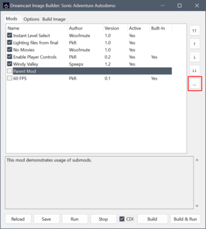

Adding Submods
Each mod can have one or more "submods". A submod has the same capabilities as a regular mod, but it doesn't appear on the main list of mods. Submods are only applied when the parent mod is enabled, and the submod is also enabled in the parent mod's configuration.
To add submods, use the Submods field in the main section of the mod.ini file.
Submods is a comma-separated list of relative paths to submods' INI files. Submods must be placed in separate subfolders within the parent mod's folder. Submod INI files can have any name except mod.ini.

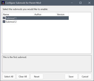

DefaultSubmods is a comma-separated list of submod names (matching the Name field in the submod's INI file) that are active by default. If this key is missing in the INI file, all submods will be enabled by default.
mod.ini
Name=Test Parent Mod
Description=This mod demonstrates usage of submods.
GameVersions=610-7029  V1.00019981016
Submods=submod1\submod1.ini,submod2\submod2.ini
DefaultSubmods=Submod 1, Submod 2
In the case of the example above, the file structure of the mod should be as follows.
The submod1 folder contains submod1.ini and the submod2 folder contains submod2.ini.
Mod structure
submod1\submod1.ini
Name=Submod 1
Description=This is the first submod.
submod2\submod2.ini
Name=Submod 2 Description=This is the second submod. GameVersions=610-7029 V1.00019981016
The player can enable or disable submods using the ... button that appears to the right of the mod list when a mod with submods is highlighted.
Configure button
Submod configuration
