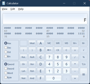

Decimal and Hexadecimal Representations
When working with data, it is often useful to represent values in the hexadecimal, rather than decimal, format. In the hexadecimal format, a single digit can be from 0 to 15, with A~F representing 10-15.
Decimal 0 1 2 3 4 5 6 7 8 9 10 11 12 13 14 15 16
Hexadecimal 0 1 2 3 4 5 6 7 8 9 A B C D E F 10
In the hexadecimal format, the decimal value 22 would be 16, and the decimal value 16 would be 10. To help distinguish hexadecimal values, the 0x prefix is used:
Uint32 value1 = 0xE; // 14
Uint32 value2 = 0x6E; // 110
For integer values, the decimal conversion of a hexadecimal value can be different depending on whether the value is supposed to be signed or not. For example, 0xFF00 would be 65280 if unsigned, and -256 if signed.

The Sonic Adventure games often use 16-bit (2 byte) or 32-bit (4 byte) values to store flags. Since a flag can only be on or off, it only requires one bit of information, and a 32-bit value can store 32 independent flags. This becomes useful because you can pass all flags to functions as a single value and check or set them independently within the function.
To understand how flags work, let's have a look at the Programming mode in Windows Calculator:
The rows of 0000 represent bit fields of the current value. The value 0xF (15) has the first four bits (bottom right) set to true. If we change the value to 0xB (11), it will have bits 0, 1 and 3 as true, and bit 2 as false. If we toggle more bits on the left, the value will grow. For example, if you set the two bottom right rows of bits to 1100 1011, the value will turn into 0xCB (203). That value has bits 0, 1, 3, 6 and 7 as true, and bits 2, 4 and 5 as false. The calculator shows 64 bits, so the entire bottom row can be used to set and check bit flags in 32-bit values.
When combined with enums, bit flags are extremely useful in modding because you can pack 32 individual flags in a single 32-bit value. To use bit flags in enums, define them like this (example from the Dreamcast Conversion mod):
