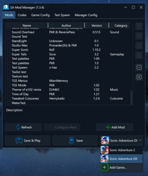

Adding SA2 if you already have the Manager installed for SADX (or vice versa)
If you have both SADX and SA2 and already have installed the SA Mod Manager on either game, you can click the game title on the bottom right of the Manager's main window and select Add Game.... After you finish adding the game, you will be able to toggle between them in the manager.

The SA Mod Manager comes with an easy way to install mods from specially formatted links. After running the Manager at least once, you should be able to simply click supported links on webpages, and the Manager will show a prompt to install the mod. A typical 1-click install link looks like this:
1-click install link on GameBanana
If the above method doesn't work for you, you can click the Manager's Add Mod button, select Installing from an URL and paste the link in the box, then click OK.
Mod download links for SADX mods start with sadxmm:.
Mod download links for SA2 mods start with sa2mm:.

If you have downloaded a mod as an archive, you can click the Add Mod button in the SA Mod Manager, select Installing from an archive, click OK, then select the file you have downloaded.

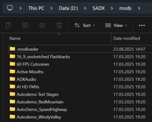

Installing Mods Manually
To install a mod manually, you need to create a subfolder in the mods folder (located in your game folder) and extract the mod's contents there. Do not extract mods directly to the mods folder! Each mod should be in a separate subfolder:
Note that mods may require additional dependencies, such as Visual C++ runtimes or other mods.
