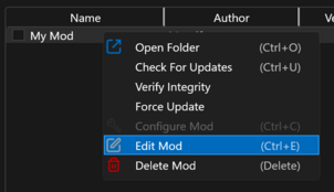

To configure automatic updates, open the Mod Manager, right click your mod and select "Edit Mod" (or select the mod and press Ctrl+E)
In the edit mode window, click on the "Update Info" tab.
Now choose the service of your choice.

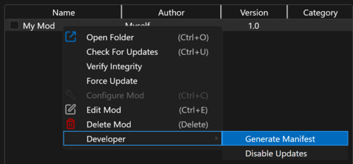

For the first time, you need to enable the developer options of the Mod Manager. Go to the "Manager Config" tab and check the "Enable Developer Options" checkbox.
1. Right click your mod, then select "Developer" >"Generate Manifest"
2. If you have modified something, the Manifest Generator window will pop up showing what's changed.
(If some of these files won't be in the released zip, uncheck them. By default the Mod Manager automatically ignores config.ini)
3. Click "OK", you may now release the update.
