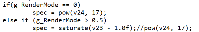

Specular Lighting
The Specular calculation formula for the Ninja Lights is currently unknown for Basic models. For Chunk models (which SA1 DC doesn't use), the formula was reversed by Exant for Simple and Easy lights:
