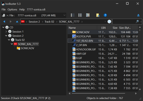

Extracting CDI files
If your game is in the CDI format, you can use the trial version of ISOBuster to extract it. Open the CDI file in the program, select the session on the left and the files on the right. Make sure you've selected the file 1ST_READ.BIN and the SONICADV folder. Usually these are found in Session 2 Track 02. Sometimes the SONICADV folder is also located on Session 1 Track 01. Extract both tracks in that case. If the folder is named SONICAD, you have the wrong version of the game.
Right click the selected files and click "Extract objects", then choose an output folder. If the files extracted successfully, you can proceed to the next section.

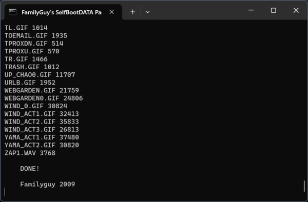

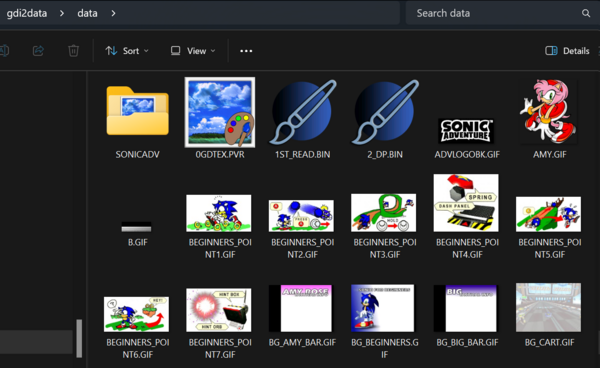

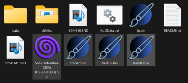

There are several different GDI formats, some of which require additional conversion before they can be processed by other software. The best supported dumps are TOSEC dumps, which contain a GDI file and files track01.bin, track02.raw (or track02.bin) and track03.bin. If your game is in the this format, you can use GDI2Data to extract files from it. If your BIN files are named differently, find a different dump.
Gdi2Data.zip
Extract the GDI2Data archive to any folder, copy the game's GDI file to the same folder (including all BIN and RAW files that come with the GDI file) and double click GDI2Data.bat. A command line window will open. When it says "DONE! FamilyGuy 2009", check if the data folder contains extracted files. If the files extracted successfully, you can proceed to the next section.

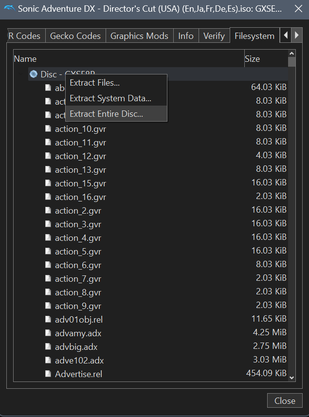

The easiest way to extract Gamecube games is with the Dolphin Gamecube emulator. Right click the game and select Properties. Go to the Filesystem tab, right click the "Disc" text and select "Extract entire disc". Choose an output folder. Now you can proceed to the next section.

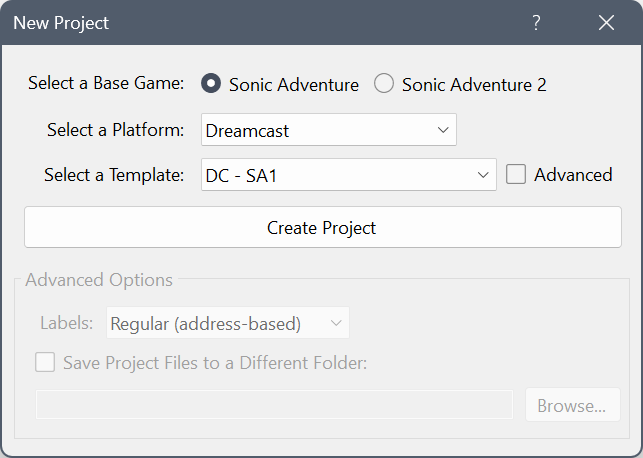

Creating a project with SA Tools Hub
Run the SA Tools Hub and click the "New Project" button.
Select the base game and the platform, then pick the template.
If you haven't created rips of this specific version of the game before, SA Tools Hub will ask for the game's location. Point it to the location of 1ST_READ.BIN (Dreamcast games) or Main.dol (Gamecube games, located in the sys folder) extracted earlier, sonic.exe (SADX PC) or sonic2app.exe (SA2 PC). If the game version is correct, the "Create Project" button will be enabled. Click it and specify the location of the project file. Once the project is created, the ripped data will be in the project folder, in the subfolder with the same name as the project.

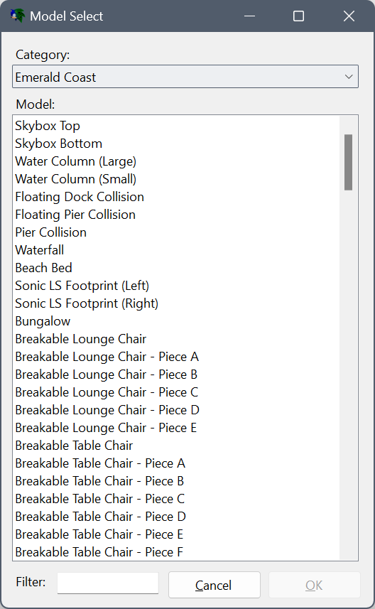

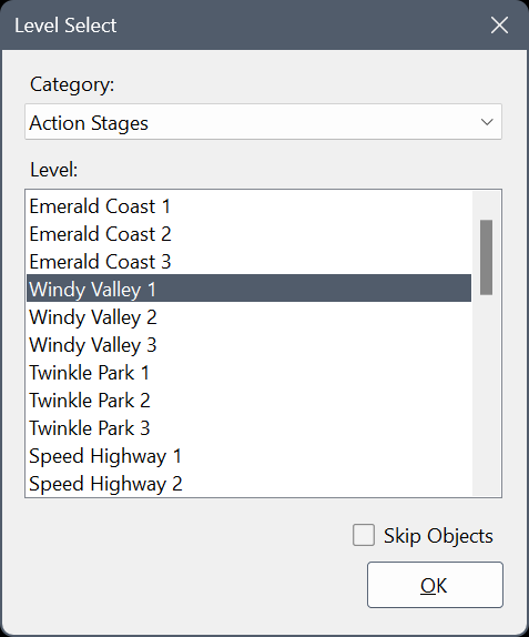

When you open the .sap file in these editors, they run in Project Mode, which auto-loads additional data such as textures, level objects etc. and lets you pick assets from a list instead of browsing through files. Although you can open individual level files (.sa*lvl) in SALVL and model files (.sa*mdl) in SAMDL, using the editors in Project Mode is recommended for ease of use.
Model select in SAMDL Project Mode
Level Select in SALVL Project Mode
