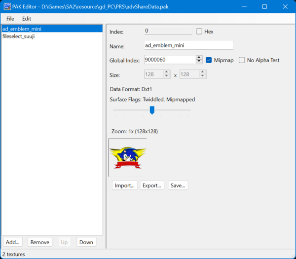

Texture Parameters
Index is the texture ID on the list. It indicates the order in which textures appear in the archive. You can change the index by sorting textures using the "Up" and "Down" buttons at the bottom of the texture list.
Name is a texture's individual name. Texture names are only stored in the archive and ignored in the games.
Global Index is a unique texture ID used in the games' texture caching system. The game checks the global index when it loads a new texture, and if a texture with the same global index is already loaded, the new texture is discarded and the previously loaded texture is reused.
The No Alpha Test checkbox controls a flag used by textures in SA2's PAK archives. This flag disables Alpha Test and Z Write, which can make transparent textures blend better or worse depending on how the model using the texture is rendered.
Size is used to view texture width and height. For textures in PVMX archives, you can override texture dimensions. This is commonly used to store the original dimensions of a non-HD UI texture when making an HD version of it to avoid stretching issues ingame. Actual Size will display the texture's current (HD) dimensions.
Data Format is the way the texture is represented in binary. It depends on the texture format, whether the texture is square or rectangular, and whether it is compressed or not. See Texture Data Formats for more information.
Pixel Format is the way and order in which the colors are stored the texture's binary data. Available pixel formats depend on the texture format. See Texture Pixel Formats for more information.
Surface Flags (SA2 PC only) are additional flags picked up by the game's renderer.

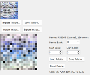

Working with Paletted (Indexed) Textures
Paletted (Indexed) textures are textures whose pixel data is represented by color indices rather than actual colors. The color indices are used to pick colors from a preset list of colors (palette) that can be built into the texture itself or loaded from an external file (PVP files for PVR textures, GVP files for GVR textures). In the Sonic Adventure games, the only case where paletted textures are used is the archive named AL_BODY, which stores Chao body textures.
There are two main formats of Indexed textures supported in the Sonic Adventure games:
- Index4 is a 4-bit format (2 pixels per byte) that can have up to 16 unique colors in the texture.
- Index8 is an 8-bit format (1 pixel per byte) that can have up to 256 unique colors in the texture.
The Sonic Adventure games only support Index4 textures natively, although you might be able to load Index8 textures in the future with the Mod Loader. Other games, such as Skies of Arcadia, PSO or Billy Hatcher, make use of both Index4 and Index8 textures.
Palette Information
When you select an Indexed texture in Texture Editor, an additional set of controls will appear under the texture preview.
On the bottom left there will be a palette preview that will display a grid containing all colors in the palette. You can click inside the preview to display information about a specific color.
On the bottom right there will be palette information: its color format, the number of colors and whether the palette is embedded into the texture (internal) or loaded from a file (external).
If no palette is currently loaded, a default palette will be created. The default palette consists of a simple gradient whose brightness corresponds to color index values in the texture.
You can use the buttons to import and export a palette as a PVP/GVP/PNG file, or unload a palette and replace it with the default one.
