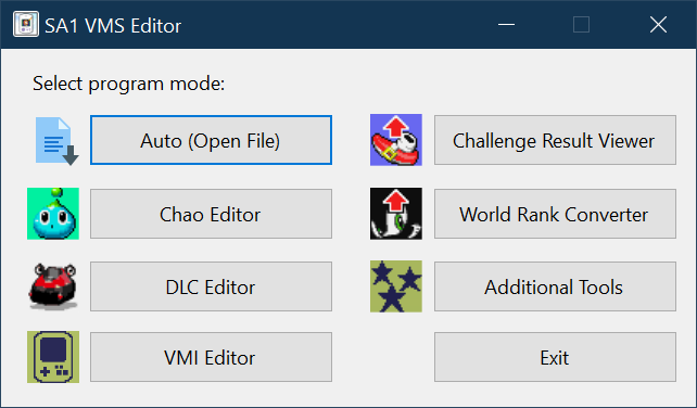

Program Mode Selector
This window lets you open a specific editor manually or auto-detect the data by file contents and open the relevant editor automatically. It also has additional tools to decode and decrypt/encrypt DLC and Upload data.

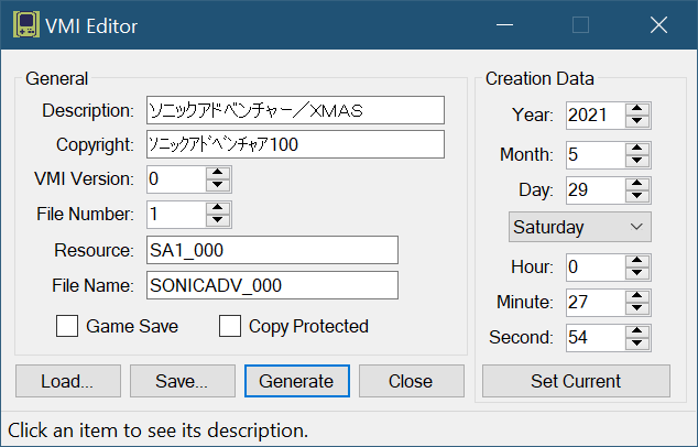

VMI Editor
A VMI file is required for the DLC to be compatible with the Dreamcast browser and some emulators (such as redream). The VMI file is also created automatically by Chao Editor and DLC Editor when you save the VMS file (this can be disabled in the Edit menu).
Resourceis the name of the VMS file to be loaded when the VMI file is opened by the browser.File Nameis the name the VMS file will have on the memory card.
Notes on VMI files
- If you want to make the file downloadable with the Dreamcast's browser, make sure the
Resourcefield matches the VMS filename on the server. For example if the VMS file is calledTIKAL.VMS, theResourcestring should beTIKAL. - Set
File Numberto 1 andVMI Versionto 0 for compatibility with SA1's built-in browser. Resourcecannot be longer than 8 characters.File Namemust be 12 characters.File Namefor DLCs must beSONICADV_XXX, whereXXXis a 3-digit number.File Namefor other files must match the default name for the data type (see Supported Files).
