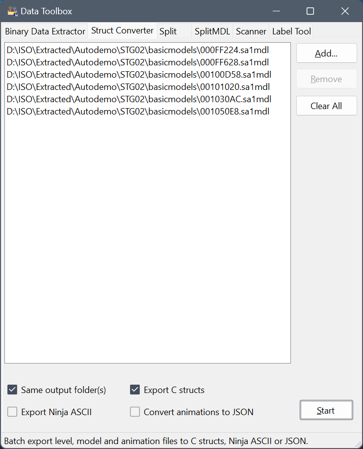

Struct Converter
This tool lets you convert levels, models and animations to C structs. Models and animations can also be exported as Ninja ASCII, and animations can be exported as JSON. You can use drag-and-drop to add files to the list.

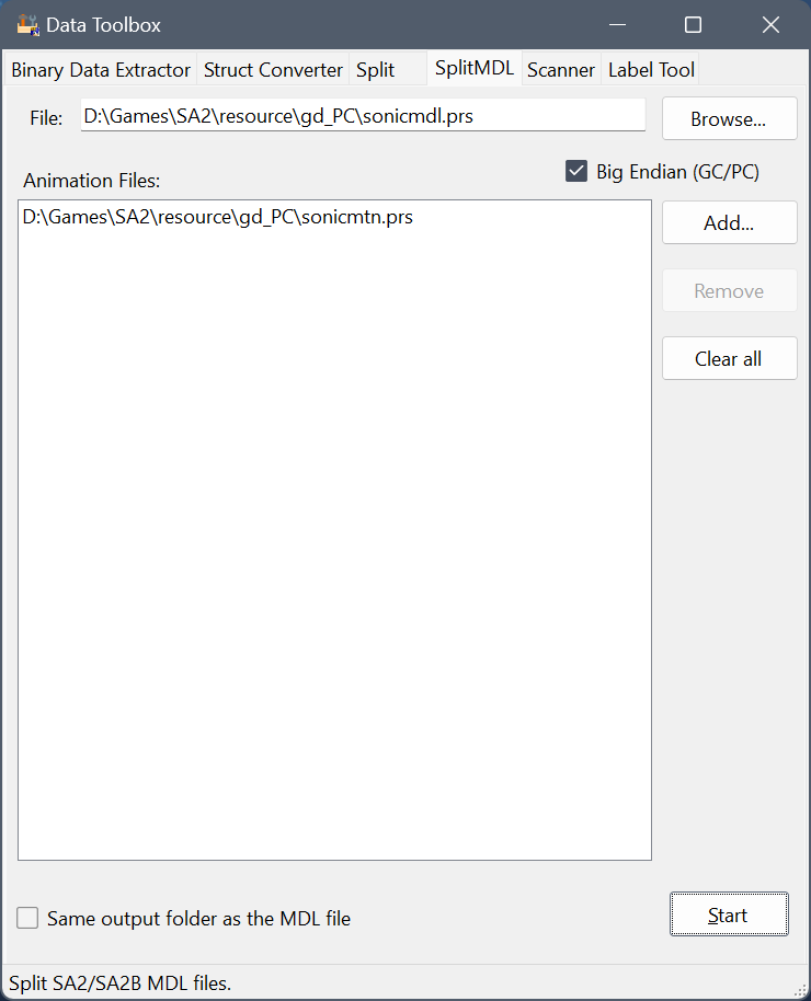

SplitMDL
This tool lets you extract data from SA2/SA2B MDL and MTN files.

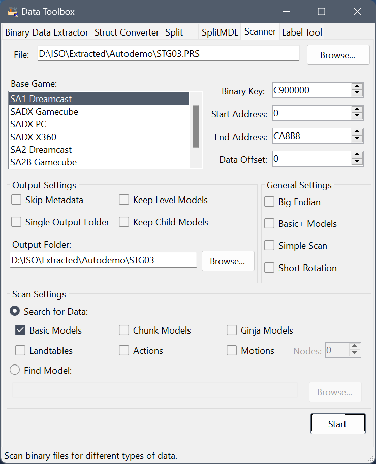

Scanner
This tool lets you scan through a binary file to find different types of data in it.
- The
Base Gamecombo box sets game-specific settings such as landtable format, reversed color order for SADX Gamecube or Endianness. Start AddressandEnd Addresscan be used if you want to scan a specific section in the file.Skip Metadatawill strip all metadata from the files. This will reduce their size but item names will be based on the item's location in the model file, not the original binary file.- When the
Keep Level Modelscheckbox is checked, the scanner will not delete models found to be part of a Landtable. - When the
Keep Child Modelscheckbox is checked, the scanner will not delete models found to be part of another model. - The
Basic+ Modelscheckbox makes the Basic model scanner look for Basic+ models (SADX PC/SADX X360) instead of regular Basic models (SA1 DC, SADX Gamecube). Simple Scanuses a less strict check to determine whether model data is valid.Short Rotationtreats rotation value in Motions asshortinstead ofint. Some Chao animations use this.- The
Nodesnumberic box lets you set the minimum number of nodes to scan for in motions. Motions with less nodes will be discarded. Set the value to 0 to find all motions. - In
Find Modelmode, the scanner will scan for models similar to the input model. At the moment only Basic and Basic+ models are supported.

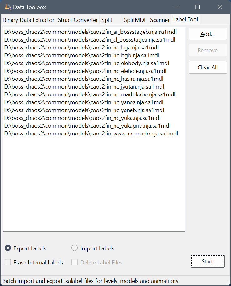

Label Tool
This tool lets you import and export labels embedded into SAModel files using external .salabel files.
- The
Export Labelsradio button makes the tool save all embedded labels to.salabelfiles. - Checking the
Erase Internal Labelscheckbox will make the tool clear embedded labels after exporting them. This can be used to reduce the size of SAModel files. - The
Import Labelsradio button overwrites embedded labels in SAModel files with labels found in.salabelfiles. - Checking the
Delete Label Filescheckbox will make the tool remove the.salabelfiles after reading labels from them.
