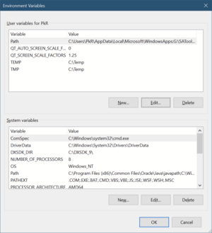

Adding the PATH Environment Variable
To make using command line tools easier, add the bin folder to your system PATH environment variable.
Go to System Properties, Advanced and Click "Environment Variables...". You will see the following window:
Environment Variables window
Select Path in in User Variables and click "Edit...". Then click New and type the location of your SA Tools' bin folder. Example:

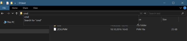

One way to launch the command prompt in the folder you need is opening the folder in Explorer and typing cmd in the address bar:

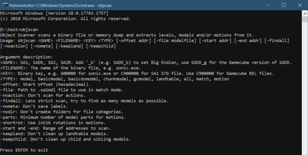

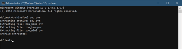

To learn how to use a specific tool, run it without command line arguments.

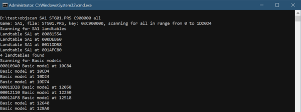

Example: Scanning SA1 STG01.PRS for levels and models using the Object Scanner. Type the following in the command prompt and press Enter:
objscan SA1 STG01.PRS C900000 all
Note: the file STG01.PRS must exist in the folder you're running the command in (D:\test in this example).
