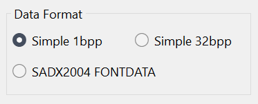

Font files in different versions of SA1 and SA2 come in various formats and their data is stored in different ways. There can also be files that share the same name but their format is different between games. When you open a font file, the editor will show a dialog asking you to select the format and character map. If you haven't renamed the file, SAFontEdit should be able to recognize it by name and content and set the necessary parameters automatically. For manual format settings, use the table below. Details on the format are below the table.
| Filename | Games | Data Format | Character map | Location | Notes |

Data formats
There are three main formats for binary font files in SADX and SA2.
Simple 1 bit per pixel: these contain bitmap data with 8 pixels packed into a single byte. There is no color or alpha information, so every pixel is either completely opaque or completely transparent. This format is used by Dreamcast and Gamecube versions of SA1/DX and SA2/B. EFMSGFONT files are in this format in all games except SA2 PC.
FONTDATA (2004) format: these contain 1-bit bitmap data along with character IDs and miscellaneous data. These are called FONTDATA0.BIN and FONTDATA1.BIN and are only used in the 2004 PC port of SADX. Note that SOC_fontdata files in SADX X360 are not in this format despite containing "fontdata" in their names.
Simple 32 bit per pixel: in bitmap data in these files, each pixel occupies 4 bytes. There is full color and alpha information. These are used by SOC_fontdata files in SADX X360 and EFMSGFONT files in SA2 PC.

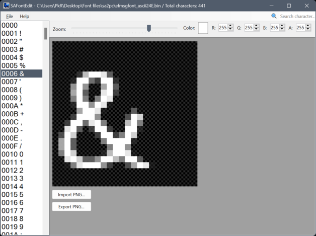

Main window
- The list box on the left lets you go to different characters. The items on the list are the character ID followed by the actual character (if it exists in the current character map).
- The "Zoom" trackbar lets you zoom in or out to make glyph editing easier.
- The "Color" box and the numeric boxes on the right let you change the current color (for 32-bit formats only). You can click the colored box to bring up the Windows color dialog. Use the A numeric box to adjust transparency.
- The glyph box lets you view and edit font bitmaps. Use the left mouse button to paint with the current color, and the right mouse button to erase.
- The "Search" box on the top right lets you search characters by ID or the actual character (if the correct character map is loaded).
- The "Import PNG" and "Export PNG" buttons let you import and export the current character image as a PNG file.
