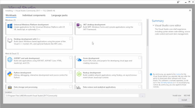

In order to build DLL files, you will need Visual Studio Community with C++ capabilities. You can download the Visual Studio Installer here.
Open the installer, choose Visual Studio Community, then "Desktop Development with C++" and wait until the installation is finished.
Note: You only need the toolkit (the latest is v143), the SDK and the debugger.

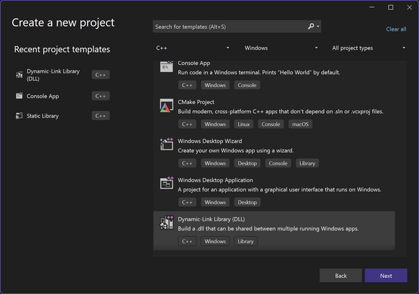

Now that Visual Studio is installed, we need to make a C++ DLL project.

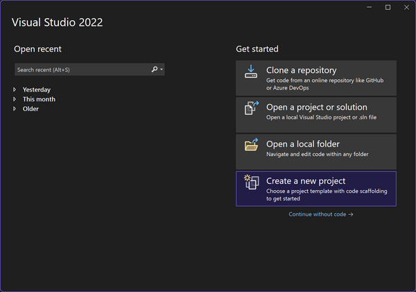

1. Click on "Create a new project" on the starting page. If there's no starting page, click on "File" then "New project".
2. Select the Dynamic Link Library (DLL) template

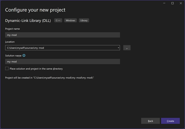

3. Choose a name and a location for your project.

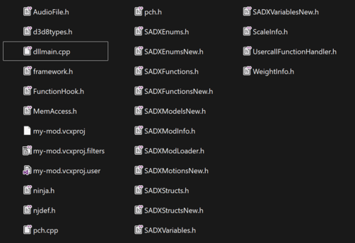

Navigate to the location you've chosen for the project. Visual Studio has created several project files.
  • The folder where the .sln file is located is called the solution folder.
  • The subfolder containing the .vcxproj and .cpp files is called the project folder.
The .cpp files are files containing C or C++ code, they will be compiled into machine code inside the DLL. The .h files are header files, they contain information that cpp files can use.

3. Move the content of SADXModLoader/include (or SA2ModLoader/include) into your project folder.
These files provide modding capabilities to your project, we will learn how to actually use them later on.

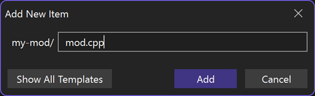

4. Creating a source file
Now we need a space to start coding, we will create a new source (.cpp) file where we will put our own code.

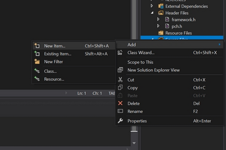

1. In Visual Studio, right click "Source Files" then click Add -> New Item...
2. Name it however you want, for example mod.cpp
3. Now we have our own space where we can start coding.

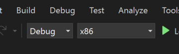

First, make sure you are building for the x86 (32bit) architecture, you can select it at the top.
Currently, it is building in the "Debug" configuration. This mode is useful for debugging and should only be used while testing your mod. Once you want to release it to the world, you should change it to the "Release" configuration and rebuild.
