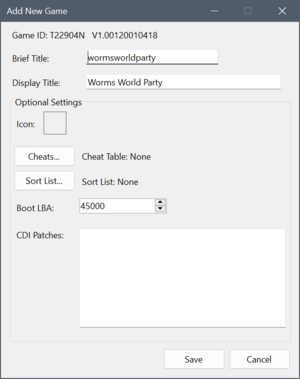

In addition to built-in games, you can add support for more games by clicking the + icon to the right of the Games list and selecting a GDI file.
When you pick a GDI file, you will see the following dialog:
Add New Game dialog
Brief Title is the internal name used by this program. It will be used as a filename base for files containing game settings. It's recommended to use short but descriptive names for game data files, such as SA1_INT1003 (Sonic Adventure International v.1.003).
Display Title is the game's name that will appear on the Games list. Note that each game configuration must have a unique title.
The settings below are optional.
Icon is an icon associated with the game. It is only used for cosmetic purposes. Click the box to locate a bitmap or icon file. If you click Cancel in the open file dialog, the current icon will be cleared.
Cheats locates a RetroArch .cht file associated with this version of the game. If you specify a valid cheat sheet, the Codes tab will appear when this game is selected. If you click Cancel in the open file dialog, the current cheat table will be cleared.
Sort List locates a file list used for arranging files in a specific order (such as the sort files exported by GD-ROM Explorer). It's only used for building CDI files. If you click Cancel in the open file dialog, the current sort list will be cleared.
Boot LBA is the value used for selfbooting CDI. It depends on the game and the selfboot method used.
CDI Patches is a list of hacks for 1ST_READ and other binaries required to boot the CDI. CDI patches are in the following format:
Comment,Filename,Offset,Type,Count,Value
For more information on patches, see the section below.
