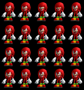

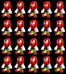

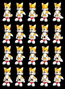

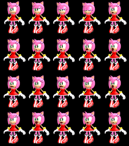

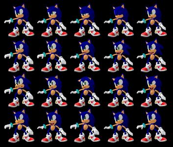

For Sonic, Tails, Knuckles, Amy and Tikal, there are 20 raw expressions that faceNo can use. While it's possible through directly editing pwp->pfp or ewp->face, the game doesn't have a way to manually fix the character on one face - it can only play animations through the methods given above.
Sonic
Tails
Knuckles
Amy
Sonic
Tails
Knuckles
Amy

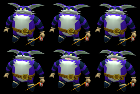

Eggman and Gamma don't have faces and nothing happens if they're told to use one. Big is a unique case, as he has facial expressions but they aren't used. He also has a few issues with using his talk head model:
- He only has 6 faces, which causes most animations (which use higher values) to crash the game.
- His head model has two pairs of eyes, causing his eyelids to be obscured between the two.
- The game makes it look like Big opens his mouth during certain animations by having his jaw attached to his body's model, which when using the talk head causes him to look like he has two mouths.
Big
Big (Extras removed)
